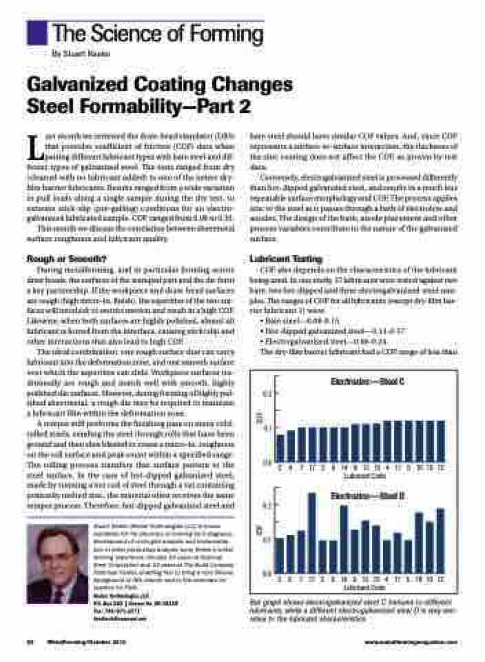

Lubricant Testing
COF also depends on the characteristics of the lubricant being used. In one study, 17 lubricants were tested against two bare, two hot-dipped and three electrogalvanized-steel sam- ples. The ranges of COF for all lubricants (except dry-film bar- rier lubricant 1) were:
• Bare steel—0.08-0.15
• Hot-dipped galvanized steel—0.11-0.17
• Electrogalvanized steel—0.08-0.24.
The dry-film barrier lubricant had a COF range of less than
    0.2
0.1
0.0
0.2
0.1
0.0
2 8 7 17 3 6 14 9 13 15 4 11 5 16 10 12 Lubricant Code
Electrozinc—Steel C
                        Electrozinc—Steel D
  92 MetalForming/October 2014
Bar graph shows electrogalvanized steel C immune to different lubricants, while a different electrogalvanized steel D is very sen- sitive to the lubricant characteristics.
