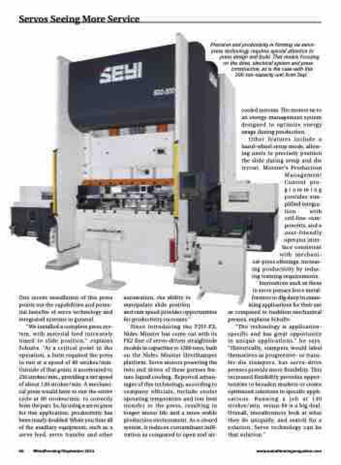

Precision and productivity in forming via servo- press technology requires special attention to
press design and build. That means focusing on the drive, electrical system and press construction, as is the case with this
200-ton-capacity unit from Seyi.
