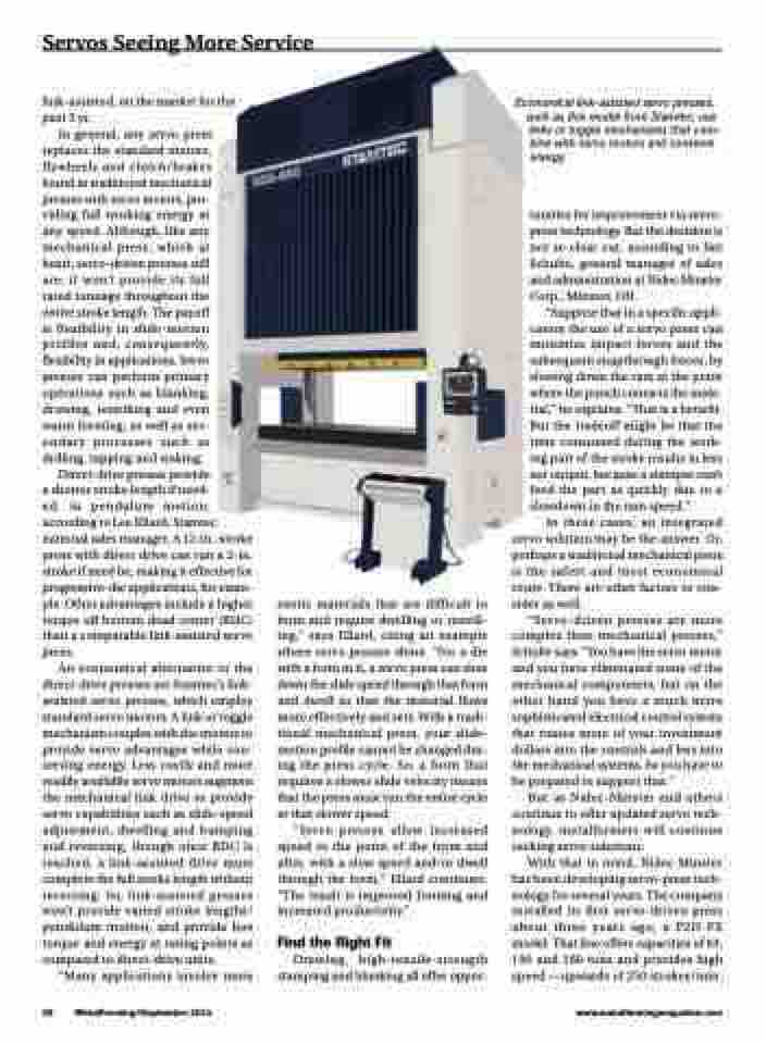

Economical link-assisted servo presses, such as this model from Stamtec, use
links or toggle mechanisms that com- bine with servo motors and conserve energy.
