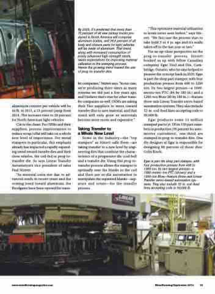

Egar is part die shop part stamper, with four production presses from 400 to 1200 ton. Its two largest presses—a 1000-metric-ton PTC (shown) and a 1200-ton Blow—feature three-axis Linear Transfer servo-based automation sys- tems. They also include 72-in. coil-feed lines accepting coils to 50,000 lb.
