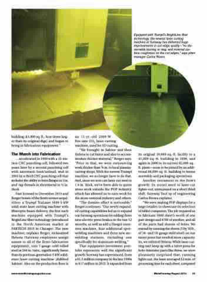

Fast forward to December 2013 and Berger boasts of the firm’s newest acqui- sition: a Trumpf TruLaser 5030 5-kW solid-state laser-cutting machine with fiberoptic beam delivery, the first such machine equipped with Trumpf ’s BrightLine fiber technology (introduced to the North American market at FABTECH 2013 in Chicago). The new machine, explains Berger, nicknamed Helena (Sureway employees assign names to all of the firm’s fabrication equipment), cuts 7-gauge cold-rolled steel at 244 in./min., significantly faster than its previous-generation 3-kW solid- state laser-cutting machine (dubbed Sabine). Also on the production floor is

“We were making POP displays for a large retailer, to showcase its selection of tablet computers. The job required us to fabricate 5000 sheet’s worth of one part design and 4700 of another, and all of the parts had dozens of holes. We started by running the sheets (5 by 10 ft., of 16- and 18-gauge mild steel) on our turret press but needed more capacity. So, we enlisted Helena. While laser cut- ting can’t keep up with a turret press for hole-intensive parts like these, we were pleasantly surprised that, running lights out, the laser averaged 12 min. of processing time for each sheet, compared

Equipped with Trumpf’s BrightLine fiber technology, the newest laser-cutting machine at Sureway has delivered huge improvements in cut-edge quality—“no dis- cernable burring or slag, and minimal sur- face roughness on the cut edges,” says plant manager Carlos Rivera.
