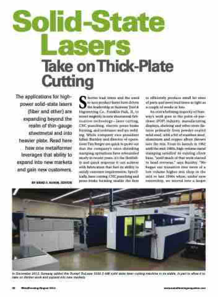

Shorter lead times and the need to turn product faster have driven the leadership at Sureway Tool & Engineering Co., Franklin Park, IL, to invest mightily in new sheetmetal-fab- rication technology—laser cutting, CNC punching, electric press-brake forming, and resistance and arc weld- ing. While company vice president Julian Burnley and director of opera- tions Tim Berger are quick to point out that the company’s once-shrinking stamping operations have rebounded nicely in recent years, it’s the flexibili- ty and quick response it can achieve with fabrication that fuel its ability to satisfy customer requirements. Specif- ically, laser cutting, CNC punching and press-brake forming enable the firm
to efficiently produce small lot sizes of parts and meet lead times as tight as a couple of weeks or less.
An overwhelming majority of Sure- way’s work goes to the point-of-pur- chase (POP) industry, manufacturing displays, shelving and other store fix- tures primarily from powder-coated mild steel, with a bit of stainless steel, aluminum and copper alloys thrown into the mix. From its launch in 1962 until the mid-1980s, high-volume metal stamping satisfied its existing client base, “until much of that work started to head overseas,” says Burnley. “We began our transition into more of a low-volume higher-mix shop in the mid to late 1990s when, under new ownership, we moved into a larger
 In December 2013, Sureway added this Trumpf TruLaser 5030 5-kW solid-state laser-cutting machine to its stable, in part to allow it to take on thicker work and expand into new markets.
