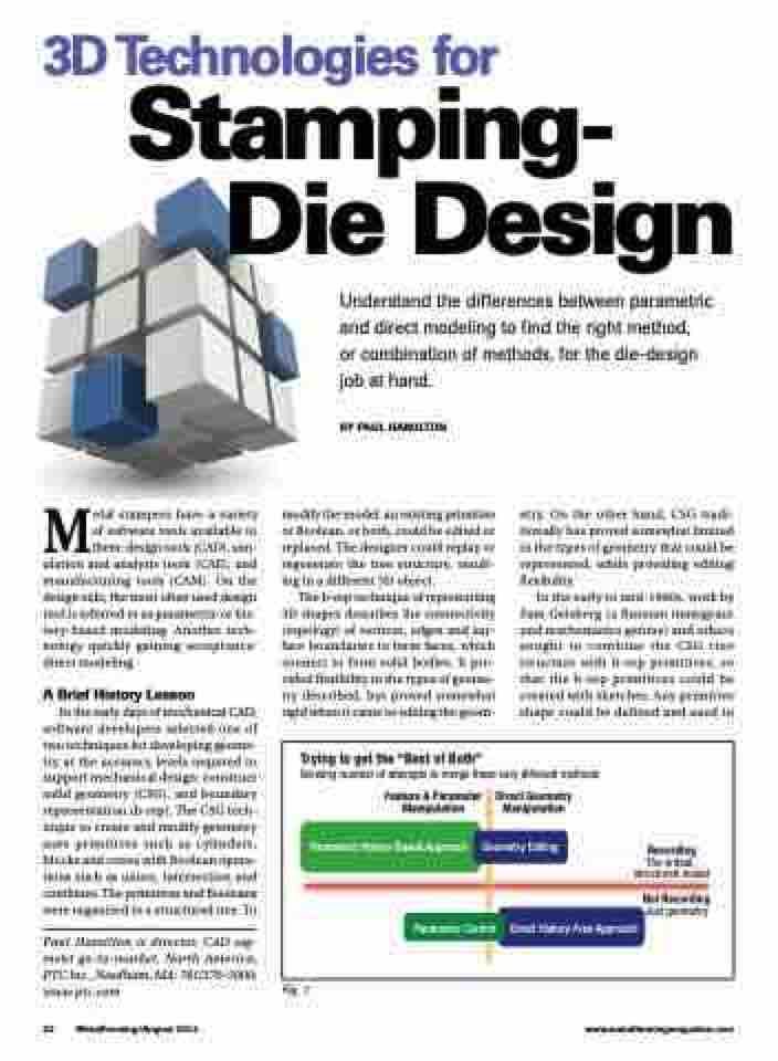

                        Trying to get the “Best of Both”
Growing number of attempts to merge these very different methods
  Feature & Parameter Manipulation
Parametric History-Based Approach
Direct Geometry Manipulation
Geometry Editing
Recording
The ordeal, structured model
Not Recording
Just geometry
         Parametric Control
Direct History-Free Approach

                           Understand the differences between parametric and direct modeling to find the right method,
or combination of methods, for the die-design job at hand.
                                  Metal stampers have a variety of software tools available to them: design tools (CAD), sim- ulation and analysis tools (CAE), and manufacturing tools (CAM). On the design side, the most often used design tool is referred to as parametric or his- tory-based modeling. Another tech- nology quickly gaining acceptance: direct modeling.
