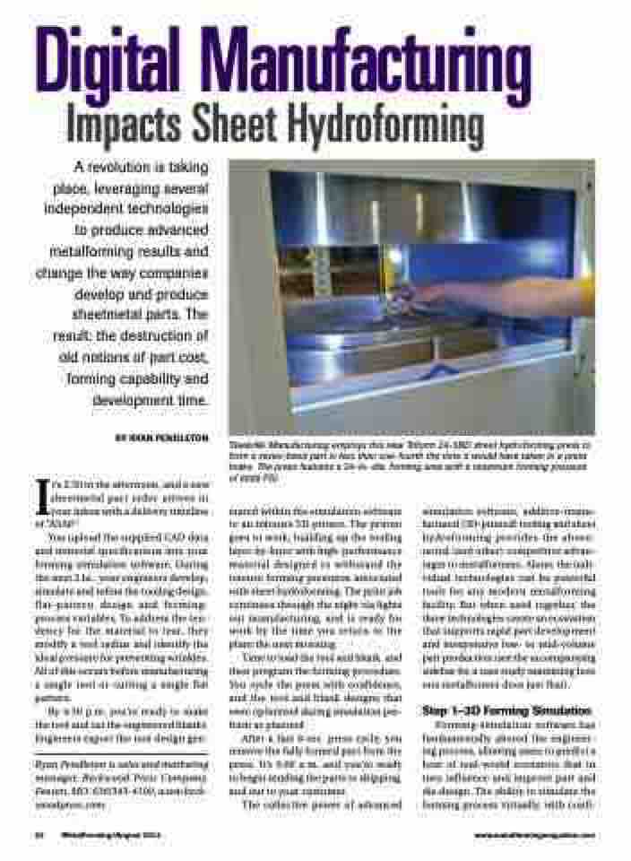

Steelville Manufacturing employs this new Triform 24-5BD sheet hydroforming press to form a seven-bend part in less than one-fourth the time it would have taken in a press brake. The press features a 24-in.-dia. forming area with a maximum forming pressure of 5000 PSI.
