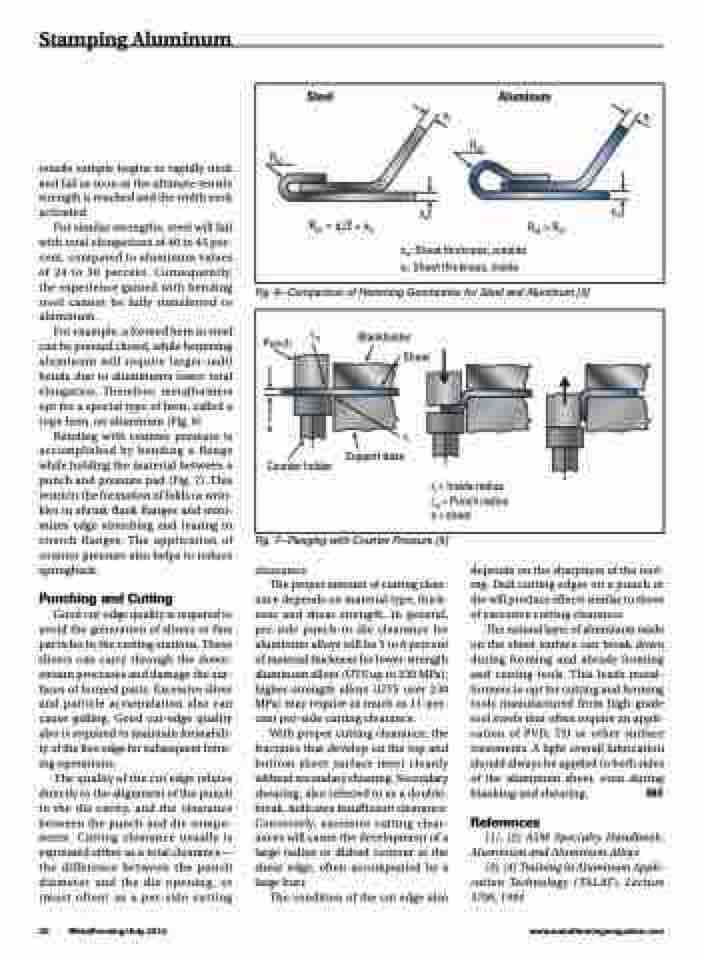

tensile sample begins to rapidly neck and fail as soon as the ultimate tensile strength is reached and the width neck activated.
For similar strengths, steel will fail with total elongations of 40 to 45 per- cent, compared to aluminum values of 24 to 30 percent. Consequently, the experience gained with bending steel cannot be fully transferred to aluminum.
For example, a formed hem in steel can be pressed closed, while hemming aluminum will require larger-radii bends due to aluminum’s lower total elongation. Therefore, metalformers opt for a special type of hem, called a rope hem, on aluminum (Fig. 6)
Bending with counter pressure is accomplished by bending a flange while holding the material between a punch and pressure pad (Fig. 7). This restricts the formation of folds or wrin- kles in shrink flank flanges and mini- mizes edge stretching and tearing in stretch flanges. The application of counter pressure also helps to reduce springback.

Fig. 6—Comparison of Hemming Geometries for Steel and Aluminum [3]
 Punch
s
rst
Blankholder Sheet
rI Support base
                                  Counter holder
  rI = Inside radius rst = Punch radius s = sheet

Fig. 7—Flanging with Counter Pressure [4]
