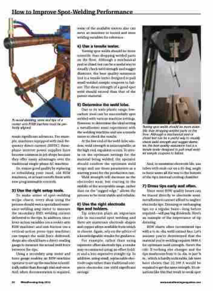

How to Improve Spot-Welding Performance
   To avoid skidding, arms and tips of a rocker-arm RSW machine must be per- fectly aligned.
made significant advances. For exam- ple, machines equipped with mid-fre- quency direct-current (MFDC) three- phase inverter power supplies have become common in job shops because they offer many advantages over the traditional single-phase AC machine.

Testing spot welds should be more scien- tific than dropping welded parts on the floor. Although a mechanical peel or chisel test can be a useful way to visually check weld strength and nugget diame- ter, the best quality-assurance tool is a tensile tester designed to pull small weld- ed sample coupons to failure.
