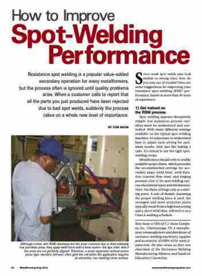

Although rocker-arm RSW machines are the most common due to their relatively low purchase price, they apply weld force with a lever action—the tips often skid if the arms are not perfectly aligned. Therefore, a more-expensive vertical-action press-type machine (shown) often gets the call when the application requires an attractive, low-marking show surface.
