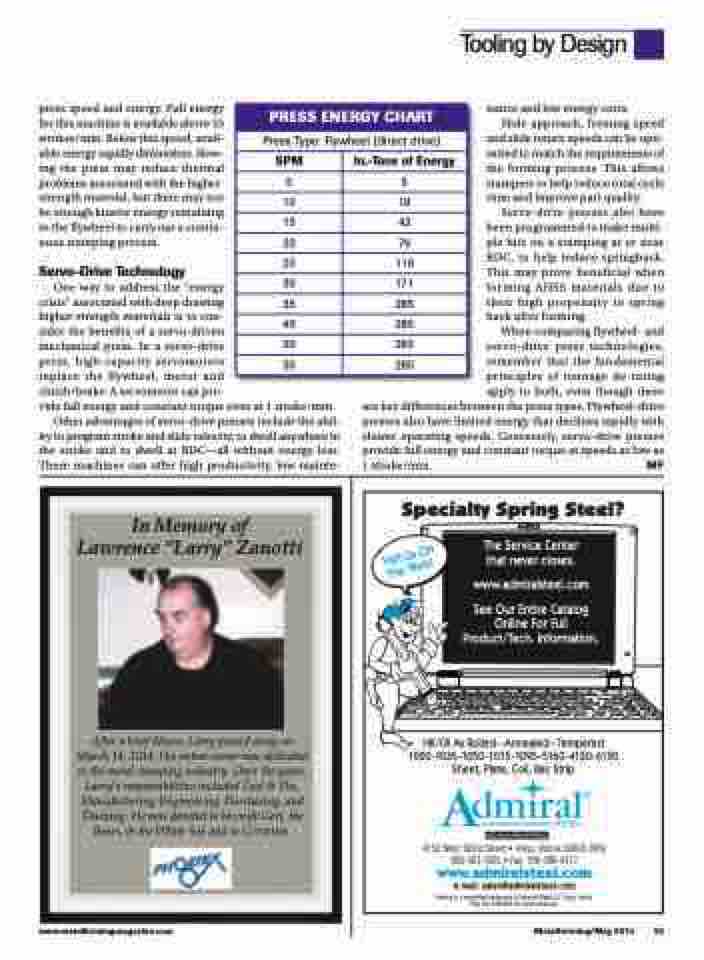

 press speed and energy. Full energy for this machine is available above 35 strokes/min. Below this speed, avail- able energy rapidly diminishes. Slow- ing the press may reduce thermal problems associated with the higher- strength material, but there may not be enough kinetic energy remaining in the flywheel to carry out a contin- uous stamping process.
Servo-Drive Technology
nance and low energy costs.
Slide approach, forming speed and slide return speeds can be opti- mized to match the requirements of the forming process. This allows stampers to help reduce total cycle
time and improve part quality. Servo-drive presses also have been programmed to make multi- ple hits on a stamping at or near BDC, to help reduce springback. This may prove beneficial when forming AHSS materials due to their high propensity to spring
back after forming.
When comparing flywheel- and
servo-drive press technologies, remember that the fundamental principles of tonnage de-rating apply to both, even though there
are key differences between the press types. Flywheel-drive presses also have limited energy that declines rapidly with slower operating speeds. Conversely, servo-drive presses provide full energy and constant torque at speeds as low as 1 stroke/min. MF
  PRESS ENERGY CHART
 Press Type: Flywheel (direct drive)
 SPM
In.-Tons of Energy
5
5
10
19
15
43
20
76
25
119
30
171
35
285
40
285
50
285
50
285
         One way to address the “energy crisis” associated with deep drawing higher-strength materials is to con- sider the benefits of a servo-driven mechanical press. In a servo-drive press, high-capacity servomotors replace the flywheel, motor and clutch/brake. A servomotor can pro- vide full energy and constant torque
     even at 1 stroke/min. Other advantages of servo-drive presses include the abil- ity to program stroke and slide velocity, to dwell anywhere in the stroke and to dwell at BDC—all without energy loss. These machines can offer high productivity, low mainte-
