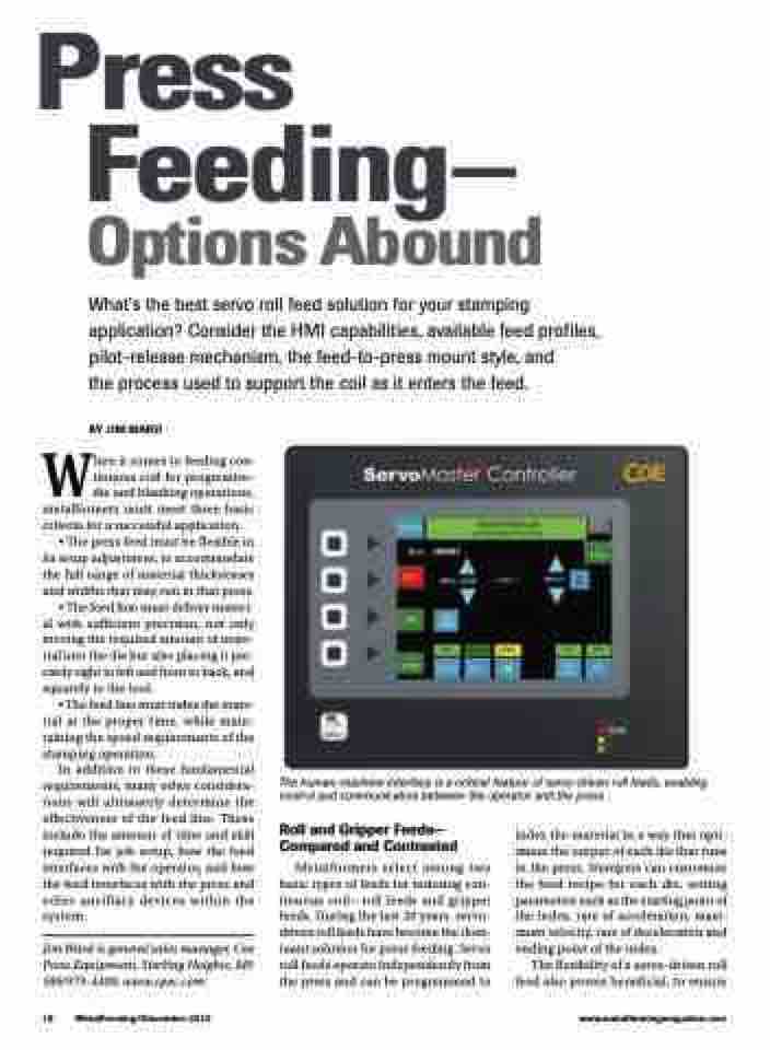

What’s the best servo roll feed solution for your stamping application? Consider the HMI capabilities, available feed profiles, pilot-release mechanism, the feed-to-press mount style, and

The human-machine interface is a critical feature of servo-driven roll feeds, enabling control and communication between the operator and the press.

Metalformers select among two basic types of feeds for indexing con- tinuous coil—roll feeds and gripper feeds. During the last 20 years, servo- driven roll feeds have become the dom- inant solution for press feeding. Servo roll feeds operate independently from the press and can be programmed to
index the material in a way that opti- mizes the output of each die that runs in the press. Stampers can customize the feed recipe for each die, setting parameters such as the starting point of the index, rate of acceleration, maxi- mum velocity, rate of deceleration and ending point of the index.
The flexibility of a servo-driven roll feed also proves beneficial, to ensure
