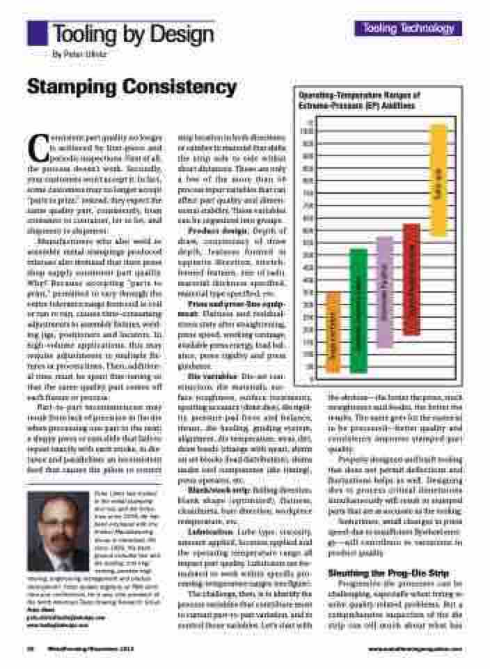

  Operating-Temperature Ranges of Extreme-Pressure (EP) Additives
oC 1000
 950
 900
 850
 800
 750
 700
 650
 600
 550
 500
 450
 400
 350
 300
 250
 200
 150
 100
50 0

Lubrication: Lube type, viscosity, amount applied, location applied and the operating temperature range all impact part quality. Lubricants are for- mulated to work within specific pro- cessing-temperature ranges (see figure).

Soaps and Esters
Synthetic, Polymeric Esters
Chlorinated Paraffins
Organo-Phosphorous cpds
Sulfur cpds
