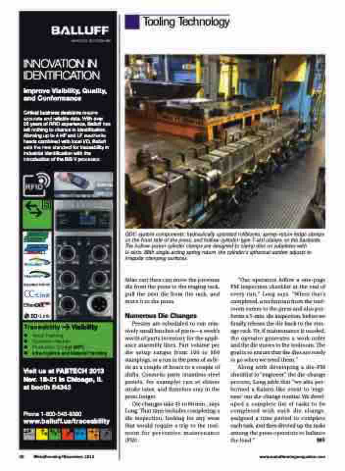

QDC-system components: hydraulically operated rollblocks; spring-return ledge clamps on the front side of the press; and hollow-cylinder-type T-slot clamps on the backside. The hollow-piston cylinder clamps are designed to clamp dies on subplates with U-slots. With single-acting spring return, the cylinder’s spherical washer adjusts to irregular clamping surfaces.
