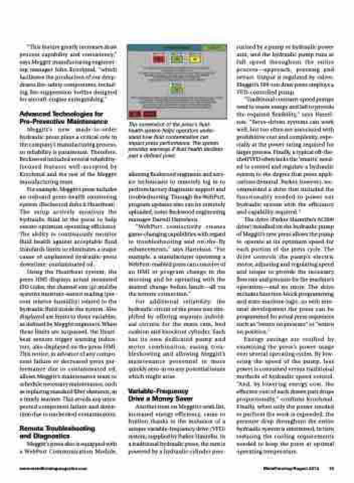

For example, Meggitt’s press includes an onboard press-health monitoring system (Beckwood dubs it Heartbeat). The setup actively monitors the hydraulic fluid in the press to help ensure optimum operating efficiency. The ability to continuously monitor fluid health against acceptable fluid standards limits or eliminates a major cause of unplanned hydraulic-press downtime: contaminated oil.
Using the Heartbeat system, the press HMI displays actual measured ISO codes, the channel size (μ) and the system’s moisture-sensor reading (per- cent relative humidity) related to the hydraulic fluid inside the system. Also displayed are limits to these variables, as defined by Meggitt engineers. When these limits are surpassed, the Heart- beat sensors trigger warning indica- tors, also displayed on the press HMI. This notice, in advance of any compo- nent failure or decreased press per- formance due to contaminated oil, allows Meggitt’s maintenance team to schedule necessary maintenance, such as replacing standard filter elements, in a timely manner. This avoids any unex- pected component failure and down- time due to unchecked contamination.

This screenshot of the press’s fluid- health system helps operators under- stand how fluid contamination can impact press performance. The system provides warnings if fluid health declines past a defined point.
