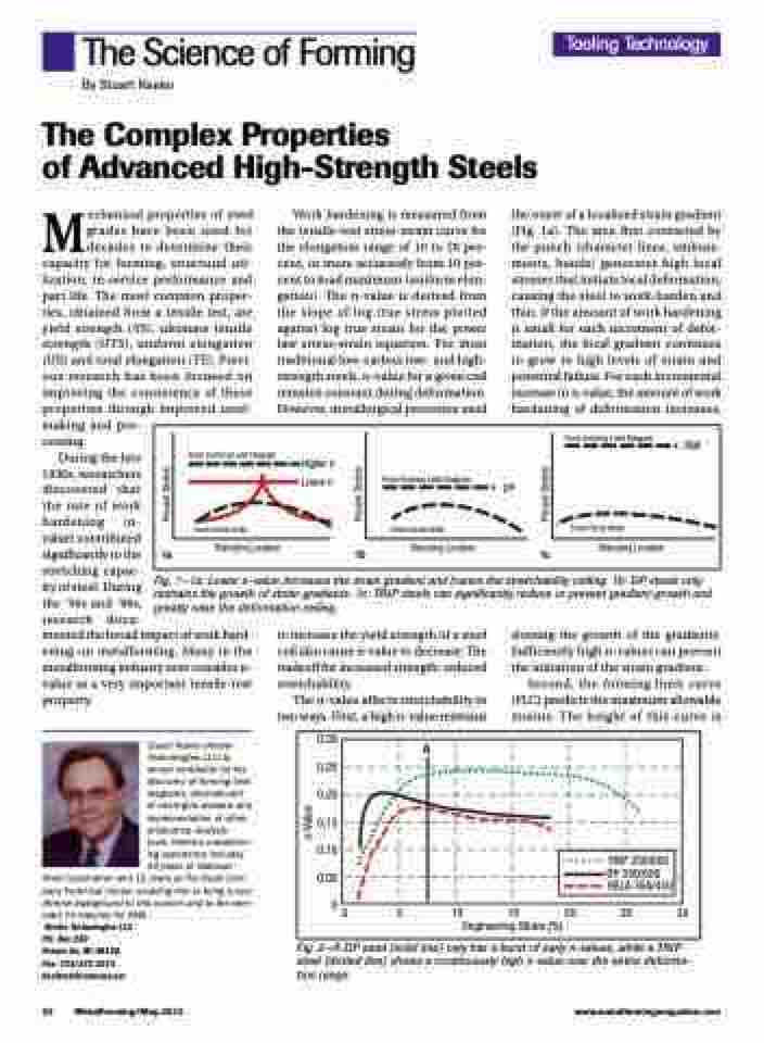

Work hardening is measured from the tensile-test stress-strain curve for the elongation range of 10 to 20 per- cent, or more accurately from 10 per- cent to load maximum (uniform elon- gation). The n-value is derived from the slope of log true stress plotted against log true strain for the power law stress-strain equation. For most traditional low-carbon low- and high- strength steels, n-value for a given coil remains constant during deformation. However, metallurgical processes used
the onset of a localized strain gradient (Fig. 1a). The area first contacted by the punch (character lines, emboss- ments, bends) generates high local stresses that initiate local deformation, causing the steel to work-harden and thin. If the amount of work hardening is small for each increment of defor- mation, the local gradient continues to grow to high levels of strain and potential failure. For each incremental increase in n-value, the amount of work hardening of deformation increases,

1a 1b 1c
Fig. 1—1a: Lower n-value increases the strain gradient and lowers the stretchability ceiling. 1b: DP steels only restrains the growth of strain gradients. 1c: TRIP steels can significantly reduce or prevent gradient growth and greatly raise the deformation ceiling.

The n-value affects stretchability in two ways. First, a high n-value restrains
slowing the growth of the gradients. Sufficiently high n-values can prevent the initiation of the strain gradient.

  0.30 0.25 0.20 0.15 0.10 0.05
00 5 10 15 20 25 30 Engineering Strain (%)

Fig. 2—A DP steel (solid line) only has a burst of early n-values, while a TRIP steel (dotted line) shows a continuously high n-value over the entire deforma- tion range.
n-Value
Percent Stretch
