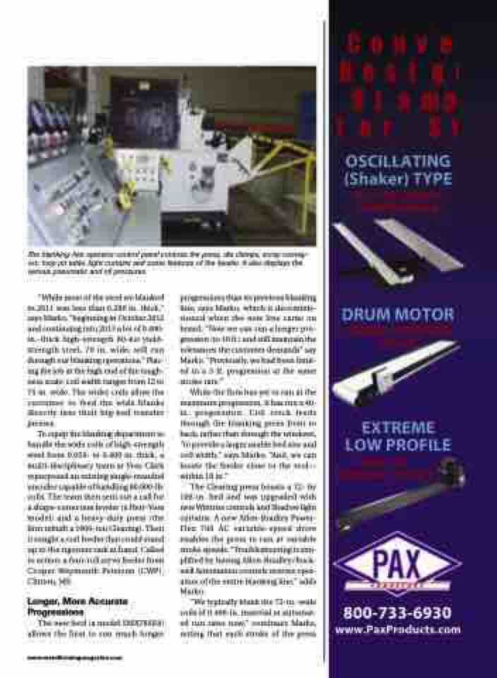

      The blanking-line operator control panel controls the press, die clamps, scrap convey- ors, loop pit table, light curtains and some features of the leveler. It also displays the various pneumatic and oil pressures.
