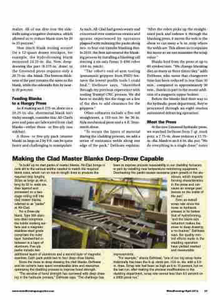

Making the Clad Master Blanks Deep-Draw Capable
 To build up its clad packs of master blanks, All-Clad brings in coils slit to the various widths needed to match the required blank sizes, which run on cut-to-length lines to produce the required strip lengths.
Strips as large as 48 in. long by 22 in. wide are then layered and processed on a two- stage rolling mill into clad master blanks, referred to as “packs” at All-Clad.
For a three-ply
blank, Type 304 stain-
less steel comprises
the inside cooking sur-
face and a magnetic
stainless-steel grade
comprises the outer
layer. Sandwiched in
between is a layer of
aluminum. Five-ply
packs include two
additional layers of aluminum and a second layer of magnetic stainless. Each pack yields two to four deep-draw blanks.
Since the move to deep drawing the clad blanks, DeHosse and his cohorts have spent considerable time and resources optimizing the cladding process to improve bond strength.
“The window of bond strength has narrowed with deep draw- ing in the hydraulic presses,” DeHosse says. “The challenge has
been to improve process repeatability in our cladding furnaces, in part by installing new temperature-monitoring equipment. Overheating the packs causes excessive grain growth in the alu-
minum, which impacts forming characteristics in the press and can cause an orange-peel texture on the inside of the pan.”
Even as overall scrap rate since the move to hydraulic presses is far below that of hydroforming, “and the blank-size reduction makes the move to deep drawing a no-brainer,” DeHosse says, the quality-con- trol efforts made in the cladding operation have yielded marked and measurable
improvements.
“For example,” shares DeHosse, “one of our big scrap items
historically has been the 8-qt. stock pot, 10.5-in. dia. with a 6.5- in. draw. Scrap rate had been as high as 8 to 10 percent, but on the last run, after making the process modifications in the cladding department, scrap rate scored less than 0.5 percent on a 3000-piece run.”
