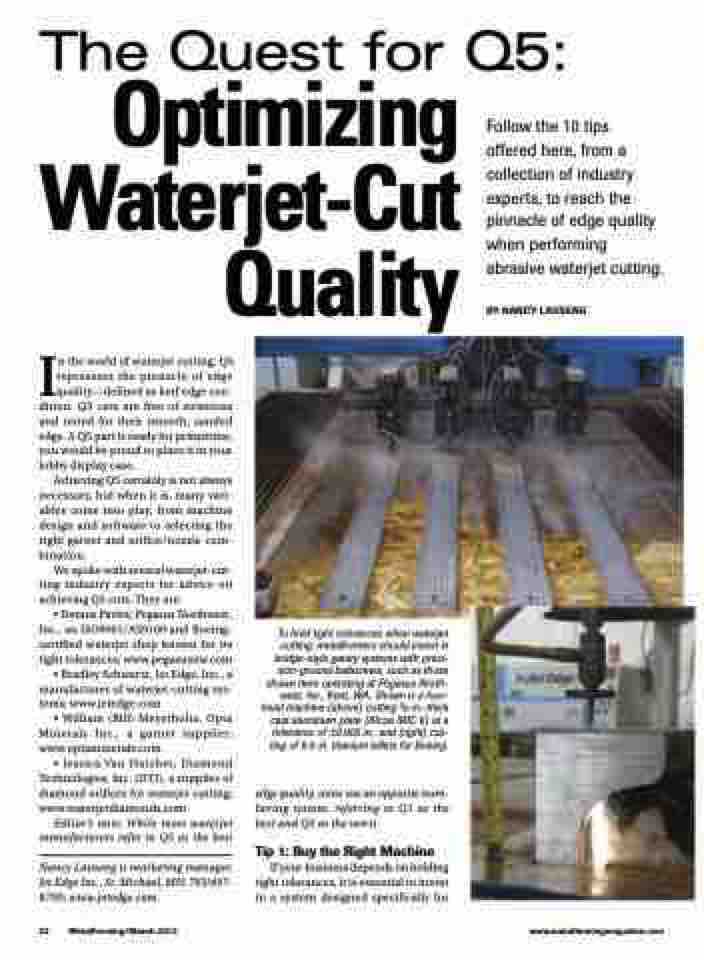

To hold tight tolerances when waterjet cutting, metalformers should invest in bridge-style gantry systems with preci- sion-ground ballscrews, such as those shown here operating at Pegasus North- west, Inc., Kent, WA. Shown is a four- head machine (above) cutting 5⁄8-in.-thick cast aluminum plate (Alcoa MIC 6) at a tolerance of ±0.005 in.; and (right) cut- ting of 6.5-in. titanium billets for Boeing.
