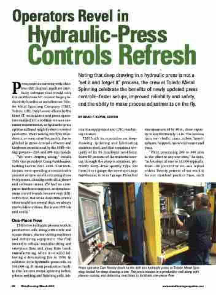

Noting that deep drawing in a hydraulic press is not a “set it and forget it” process, the crew at Toledo Metal Spinning celebrate the benefits of newly updated press controls—faster setups, improved reliability and safety, and the ability to make process adjustments on the fly.

Press operator Dan Tenney tends to the 400-ton hydraulic press at Toledo Metal Spin- ning, tooled for deep drawing a can. The press resides in a production cell along with plasma-cutting and deburring machines to facilitate one-piece flow.
