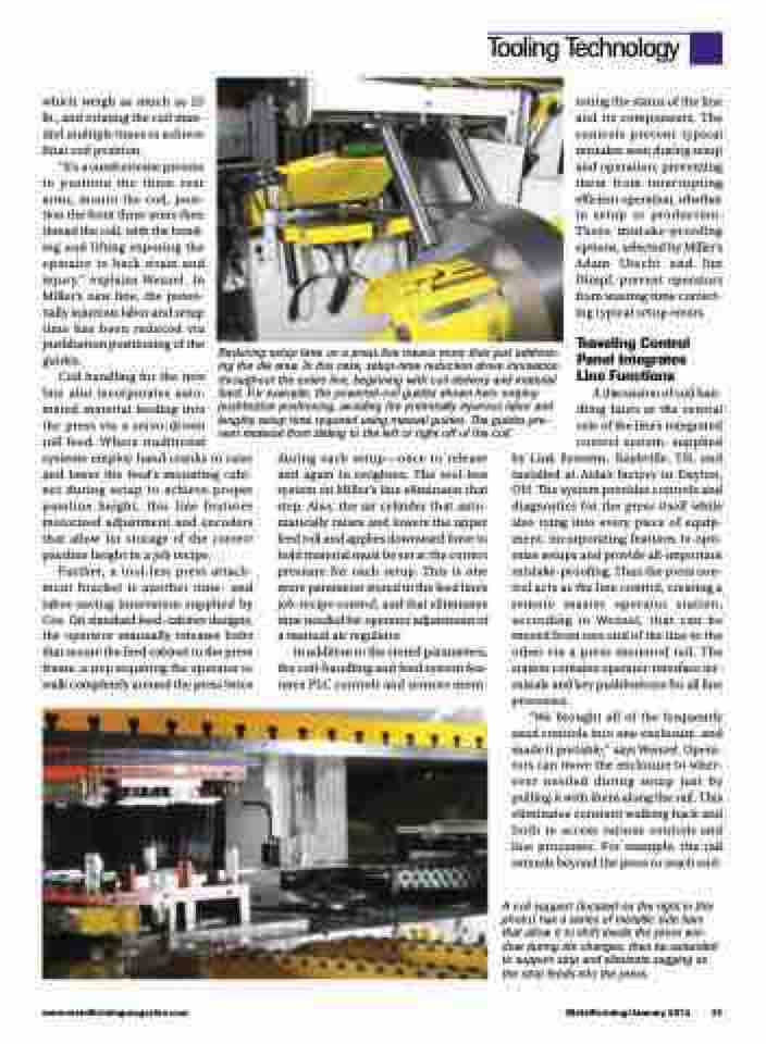

“It’s a cumbersome process to position the three rear arms, mount the coil, posi- tion the front three arms then thread the coil, with the bend- ing and lifting exposing the operator to back strain and injury,” explains Wenzel. In Miller’s new line, the poten- tially injurious labor and setup time has been reduced via pushbutton positioning of the guides.
Reducing setup time on a press line means more than just address- ing the die area. In this case, setup-time reduction drove innovation throughout the entire line, beginning with coil delivery and material feed. For example, the powered coil guides shown here employ pushbutton positioning, avoiding the potentially injurious labor and lengthy setup time required using manual guides. The guides pre- vent material from sliding to the left or right off of the coil.

A coil support (located on the right in this photo) has a series of metallic side bars that allow it to shift inside the press win- dow during die changes, then be extended to support strip and eliminate sagging as the strip feeds into the press.
