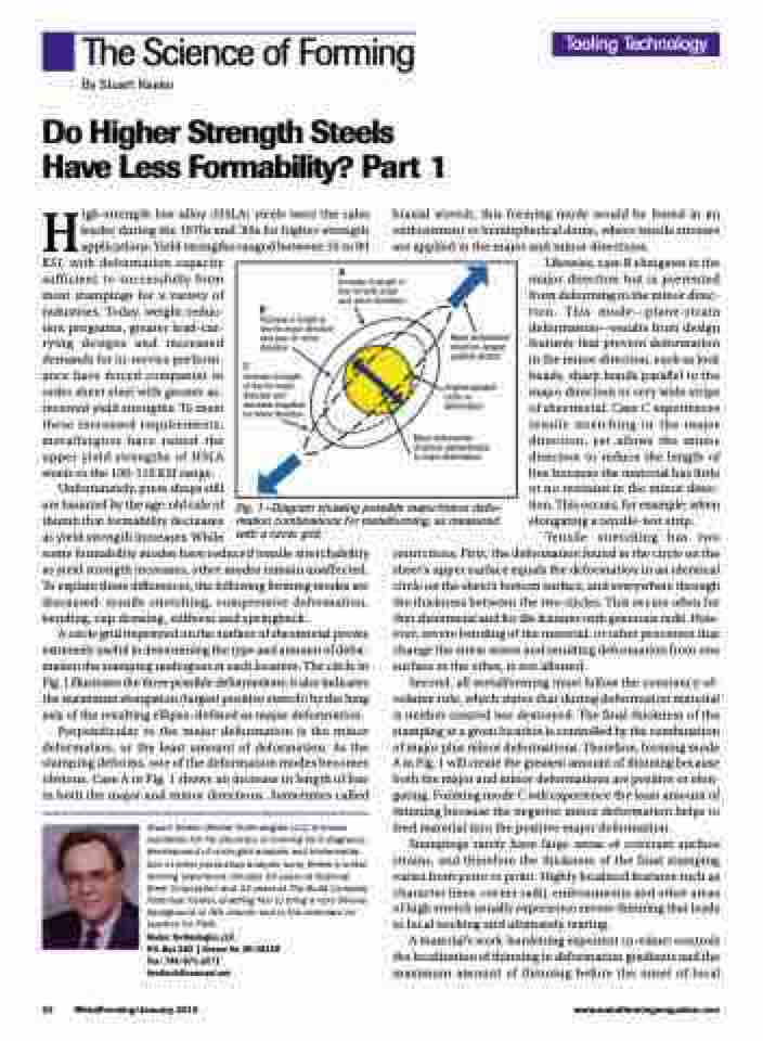

A circle grid imprinted on the surface of sheetmetal proves extremely useful in determining the type and amount of defor- mation the stamping undergoes at each location. The circle in Fig. 1 illustrates the three possible deformations; it also indicates the maximum elongation (largest positive stretch) by the long axis of the resulting ellipse–defined as major deformation.
Perpendicular to the major deformation is the minor deformation, or the least amount of deformation. As the stamping deforms, one of the deformation modes becomes obvious. Case A in Fig. 1 shows an increase in length of line in both the major and minor directions. Sometimes called

biaxial stretch, this forming mode would be found in an embossment or hemispherical dome, where tensile stresses are applied in the major and minor directions.
Likewise, case B elongates in the major direction but is prevented from deforming in the minor direc- tion. This mode—plane-strain deformation—results from design features that prevent deformation in the minor direction, such as lock beads, sharp bends parallel to the major direction or very wide strips of sheetmetal. Case C experiences tensile stretching in the major direction, yet allows the minor direction to reduce the length of line because the material has little or no restraint in the minor direc- tion. This occurs, for example, when elongating a tensile-test strip.

  Increase in length of line for major direction and zero for minor direction
Increase in length of line for major direction and decrease (negative) for minor direction
Major deformation direction–largest positive stretch
Original gridded circle no deformation
Minor deformation direction–perpendicular to major deformation
A
Increase in length of line for both major and minor directions
 B
  C
    Fig. 1—Diagram showing possible major/minor defor- mation combinations for metalforming, as measured with a circle grid.
