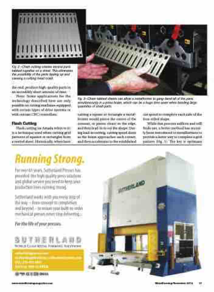

   Fig. 2—Chain cutting creates several parts tabbed together on a sheet. This eliminates the possibility of the parts tipping up and causing a cutting-head crash.

Fig. 3—Chain-tabbed sheets can allow a metalformer to gang-bend all of the parts simultaneously in a press brake, which can be a huge time saver when bending large quantities of small parts.
