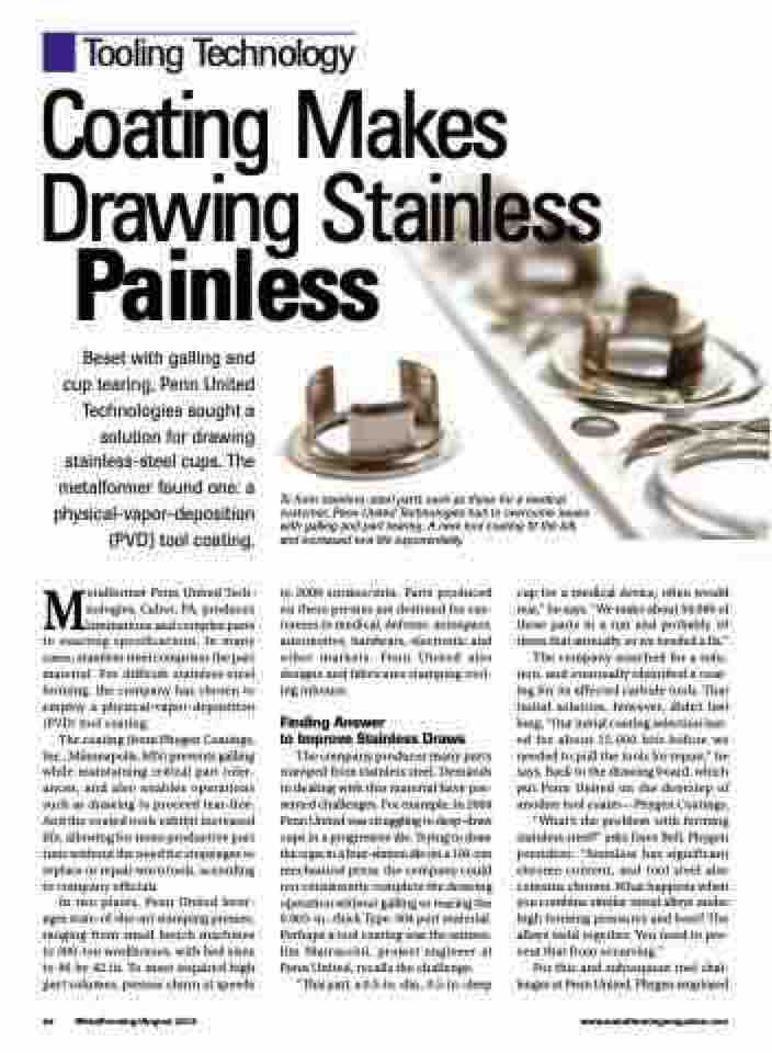

To form stainless-steel parts such as these for a medical customer, Penn United Technologies had to overcome issues with galling and part tearing. A new tool coating fit the bill, and increased tool life exponentially.
