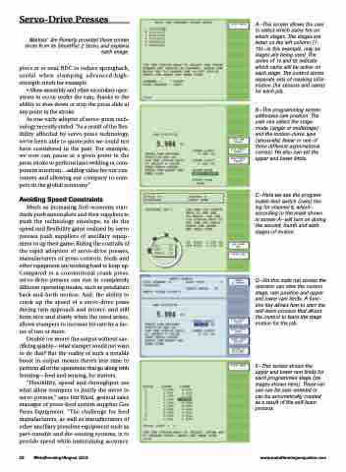

Wintriss’ Jim Finnerty provided these screen shots from its SmartPac 2 Servo, and explains each image.

A—This screen allows the user to select which cams fire on which stages. The stages are listed on the left column (1- 10)—in this example, only six stages are being used. The series of 1s and 0s indicate which cams will be active on each stage. The control stores separate sets of masking infor- mation (for sensors and cams) for each job.
B—This programming screen addresses ram position. The user can select the stage mode (single or multistage) and the motion-curve type (sinusoidal, linear or one of three different asymmetrical curves). He also can set the upper and lower limits.
C—Here we see the program- mable limit switch (cam) tim- ing for channel 8, which— according to the mask shown in screen A—will turn on during the second, fourth and sixth stages of motion.
D—On this main run screen the operator can view the current stage, ram position and upper and lower ram limits. A func- tion key allows him to start the self-learn process that allows the control to learn the stage motion for the job.
E—This screen shows the upper and lower ram limits for each programmed stage (six stages shown here). These val- ues can be user-entered or can be automatically created as a result of the self-learn process.
