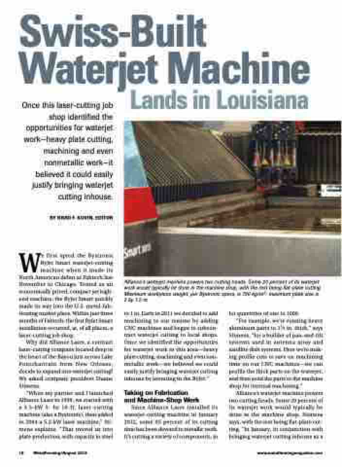

Alliance’s waterjet machine powers two cutting heads. Some 20 percent of its waterjet work would typically be done in the machine shop, with the rest being flat-plate cutting. Maximum workpiece weight, per Bystronic specs, is 790 kg/m2; maximum plate size is 3 by 1.5 m.
