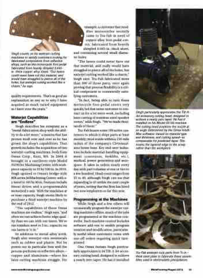

   Stegh counts on his waterjet-cutting machines to satisfy customers looking for fabricated components from reflective alloys, such as this motorcycle foot pedal fabricated from heavily dimpled 0.045- in.-thick copper-alloy sheet. “Our lasers could never have cut this material, and would have struggled to pierce all of the holes, but waterjet cutting worked like a charm,” he says.

In addition to metal-alloy work, Stegh also waterjet-cuts nonmetals such as rubber and plastic. But he points out in particular how well the process performs on reflective alloys— copper and aluminum—where his laser-cutting machines struggle. For
example, a customer that mod- ifies motorcycles recently came to Tru-Fab in need of
copper-alloy foot-pedal cov- ers, fabricated from heavily dimpled 0.045-in.-thick sheet, and containing several small-diame-
ter holes.
“The lasers could never have cut
that material, and really would have struggled to pierce all of the holes, but waterjet cutting worked like a charm,” Stegh says. Tru-Fab fabricated more than 500 of those parts, once again proving that process flexibility is a crit- ical component to consistently satis- fying customers.
“In fact, being able to turn those motorcycle foot-pedal covers very quickly led that same customer to con- tract us for a lot more work, including laser cutting of stainless-steel speaker covers,” adds Stegh. “We’ve made thou- sands of those.”

One Omax feature Stegh particu- larly appreciates is its Tilt-A-Jet acces- sory cutting head, designed to achieve a nearly zero taper. He has it installed
Stegh particularly appreciates the Tilt-A- Jet accessory cutting head, designed to achieve a nearly zero taper. He has it installed on his Model 55100 machine. The cutting head positions the nozzle at an angle determined by the Omax Intelli- Max software—based on material type and thickness, and cutting speed—to compensate for predicted taper. This moves the tapered edge to the scrap rather than the workpiece.
Tru-Fab waterjet-cuts parts from 3⁄8-in.- thick steel plate to fabricate these assem- blies used in electrostatic precipitators.
