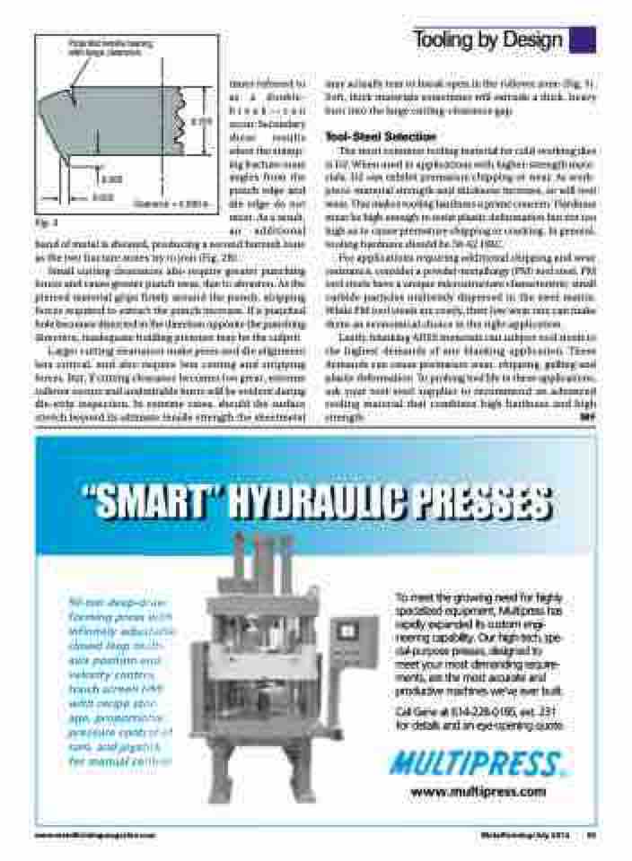

 Fig. 3
Potential tensile tearing with large clearance
Tooling by Design
may actually tear or break open in the rollover zone (Fig. 3). Soft, thick materials sometimes will extrude a thick, heavy burr into the large cutting-clearance gap.

0.060 0.050
0.250
Clearance = 0.090 in.
times referred to as a double- breakā€”can occur. Secondary shear results when the stamp- ing fracture-zone angles from the punch edge and die edge do not meet. As a result, an additional
band of metal is sheared, producing a second burnish zone as the two fracture zones try to join (Fig. 2B).
Small cutting clearances also require greater punching forces and cause greater punch wear, due to abrasion. As the pierced material grips firmly around the punch, stripping forces required to extract the punch increase. If a punched hole becomes distorted in the direction opposite the punching direction, inadequate holding pressure may be the culprit.
Larger cutting clearances make press and die alignment less critical, and also require less cutting and stripping forces. But, if cutting clearance becomes too great, extreme rollover occurs and undesirable burrs will be evident during die-strip inspection. In extreme cases, should the surface stretch beyond its ultimate tensile strength the sheetmetal
