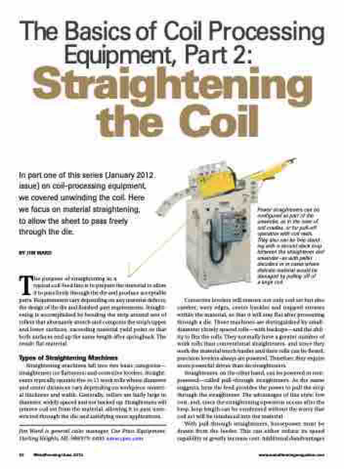

Power straighteners can be configured as part of the unwinder, as in the case of coil cradles, or for pull-off operation with coil reels. They also can be free stand- ing with a second slack loop between the straightener and unwinder—as with pallet decoilers or in cases where delicate material would be damaged by pulling off of
a large coil.
