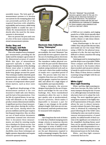

Electronic Data Collection Using “Datamytes”
Though a number of such devices are available, the term “datamyte” has practically become a generic name for the use of a bushing and an electronic transducer to check panel dimensions. The transducer makes physical con- tact with the part and the dimensions are collected in a database for future analysis using statistical tools such as x-bar and r charts that enable tracking of results over a specified period of time. The process takes less time to complete than does use of feeler, step and pin gauges, requires less operator skill, and allows for a high degree of repeatability and reproducibility.
Using a datamyte, the process designer must plan for the use of trans- ducers and budget for the cost of the bushings. Also, these standardized transducers allow the user to check part quality only at predetermined, discrete positions, which makes it impossible to measure a part for V-gaps or any changes in the profile along its length. Hole sizes are not eas- ily measured, and hole positions must be measured with templates.

The term “datamyte” has practically
check panel dimensions. The transducer makes physical contact with the part and
such as x-bar and r charts.
