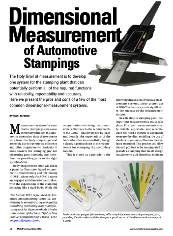

Feeler and step gauges (shown here) offer simplicity when measuring stamped parts, providing the die maker and the stamper a good sense of the dimensional accuracy of a panel.
