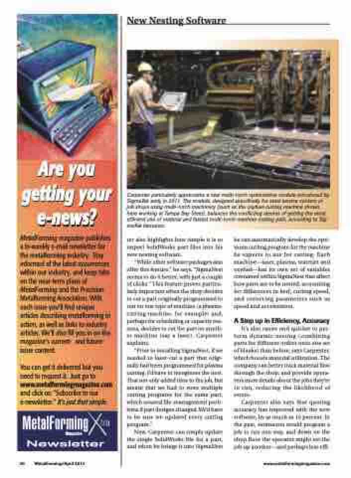

   Carpenter particularly appreciates a new multi-torch optimization module introduced by SigmaTek early in 2011. The module, designed specifically for steel service centers or job shops using multi-torch machinery (such as the oxyfuel-cutting machine shown here working at Tampa Bay Steel), balances the conflicting desires of getting the most efficient use of material and fastest multi-torch machine cutting path, according to Sig- maTek literature.
