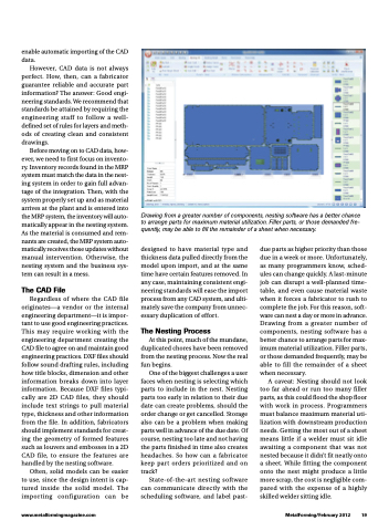

Drawing from a greater number of components, nesting software has a better chance to arrange parts for maximum material utilization. Filler parts, or those demanded fre- quently, may be able to fill the remainder of a sheet when necessary.
