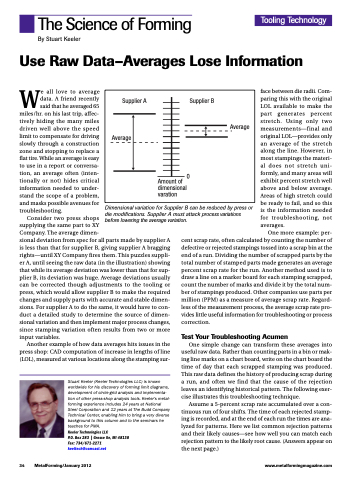

Consider two press shops
supplying the same part to XY
Company. The average dimen-
sional deviation from spec for all parts made by supplier A is less than that for supplier B, giving supplier A bragging rights—until XY Company fires them. This puzzles suppli- er A, until seeing the raw data (in the illustration) showing that while its average deviation was lower than that for sup- plier B, its deviation was huge. Average deviations usually can be corrected though adjustments to the tooling or press, which would allow supplier B to make the required changes and supply parts with accurate and stable dimen- sions. For supplier A to do the same, it would have to con- duct a detailed study to determine the source of dimen- sional variation and then implement major process changes, since stamping variation often results from two or more input variables.

   Supplier A
Average
Supplier B
0 Amount of
dimensional varation
Average
                         Dimensional variation for Supplier B can be reduced by press or die modifications. Supplier A must attack process variations before lowering the average variation.
