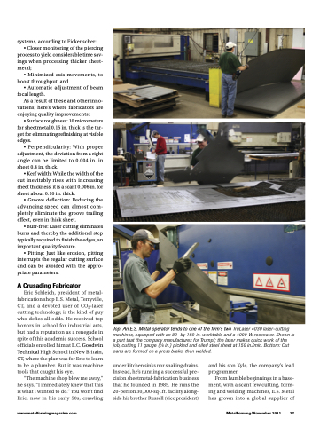

Top: An E.S. Metal operator tends to one of the firm’s two TruLaser 4030 laser-cutting machines, equipped with an 80- by 160-in. worktable and a 4000-W resonator. Shown is a part that the company manufactures for Trumpf; the laser makes quick work of the job, cutting 11 gauge (1⁄8 in.) pickled and oiled steel sheet at 150 in./min. Bottom: Cut parts are formed on a press brake, then welded.
