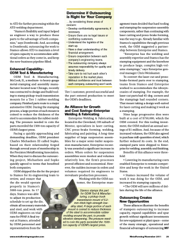

Stamco stamps this part for ODM Tool & Manufac-
turing, a pickup-truck transmission mount of 5.2- mm-thick high-strength low-
alloy steel. A large portion of each mount is coined to reduce thickness
of the steel to accommodate rubber molding around the part, to provide
vibration dampening. The pressure need- ed to coin the parts exceeded the 1500- ton capacity of ODM’s largest press.
