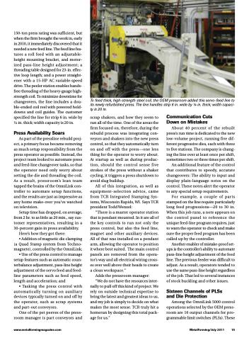

150-ton press rating was sufficient, but when the firm brought the work in, early in 2010, it immediately discovered that it needed a new feed line. The feed line fea- tures a roll feed with an adjustable- height mounting bracket, and motor- ized pass-line height adjustment; a threading table designed for 23-in. effec- tive loop length; and a power straight- ener with a 15-HP AC variable-speed drive. The peeler station enables hands- free threading of the heavy-gauge high- strength coil. To minimize downtime for changeovers, the line includes a dou- ble-ended coil reel with powered hold- downs and coil guides. The customer specified the line for strip 6 in. wide by 1⁄4 in. thick; width capacity is 20 in.

To feed thick, high-strength steel coil, the OEM pressroom added this servo-feed line to its newly refurbished press. The line handles strip 6 in. wide by 1⁄4 in. thick; width capaci- ty is 20 in.
