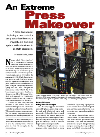

No one yelled, “Move that bus,” like Ty Pennington of Extreme Makeover: Home Edition regu- larly does. But pressroom personnel at an outdoor power-equipment OEM metalforming and fabrication plant surely celebrated when its newly made- over stamping press debuted in the summer of 2010. While Pennington and his crew work their home-make- over during a frantic week of work, this press makeover took 6 weeks to com- plete. The job: completely rebuild an aging 150-ton Bliss straightside mechanical press, with 36- by 60-in. bed; integrate a new servo-feed line to the press, capable of delivering 1⁄4-in.- thick high-strength (to 70 KSI yield strength) steel coil; and add a magnet- ic die-clamping system to the press.
Last but not least, the press line received a new nerve center: an OmniLink 5000 press and automation controller from Link Systems, Nashville, TN, selected to support numerous press- line inputs and outputs to optimize quick-setup and mistake-proofing efforts.
Editor’s note: At press time, managers at the OEM described in this article asked to have the company name removed from the text. We apologize for the inconvenience.
This completely rebuilt 150-ton Bliss straightside now boasts a new nerve center: an OmniLink 5000 press and automation controller, selected to support numerous press- line inputs and outputs to optimize quick-setup and mistake-proofing efforts.
