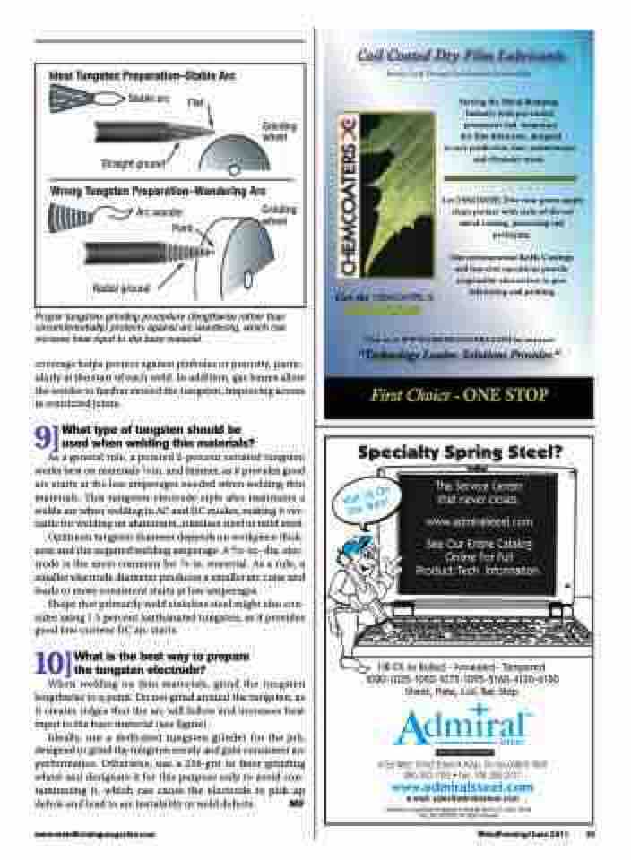

 Ideal Tungsten Preparation–Stable Arc
Stable arc
Straight ground
Flat
Wrong Tungsten Preparation–Wandering Arc
Arc wander Point
Radial ground
Grinding wheel
Proper tungsten-grinding procedure (lengthwise rather than circumferentially) protects against arc wandering, which can increase heat input to the base material.

10]What is the best way to prepare the tungsten electrode?
When welding on thin materials, grind the tungsten lengthwise to a point. Do not grind around the tungsten, as it creates ridges that the arc will follow and increases heat input to the base material (see figure).
Ideally, use a dedicated tungsten grinder for the job, designed to grind the tungsten evenly and gain consistent arc performance. Otherwise, use a 250-grit or finer grinding wheel and designate it for this purpose only to avoid con- taminating it, which can cause the electrode to pick up debris and lead to arc instability or weld defects. MF
