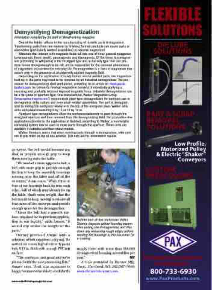

Buhrke end-of-line technician Veljko Sisarica inspects airbag-housing assem- blies exiting the demagnetizer, and files down any remaining rough edges before sending the housings to the customer for e-coating.
supply them with more than 350,000 demagnetized housing assemblies per year.” MF
