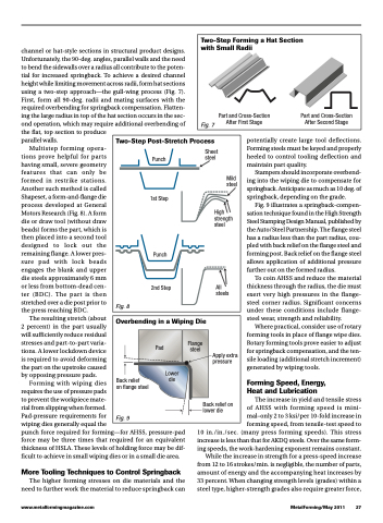

   Two-Step Forming a Hat Section with Small Radii
Part and Cross-Section Part and Cross-Section After First Stage After Second Stage
     Fig. 7
channel or hat-style sections in structural product designs. Unfortunately, the 90-deg. angles, parallel walls and the need to bend the sidewalls over a radius all contribute to the poten- tial for increased springback. To achieve a desired channel height while limiting movement across radii, form hat sections using a two-step approach—the gull-wing process (Fig. 7). First, form all 90-deg. radii and mating surfaces with the required overbending for springback compensation. Flatten- ing the large radius in top of the hat section occurs in the sec- ond operation, which may require additional overbending of the flat, top section to produce
parallel walls.
Multistep forming opera-
tions prove helpful for parts having small, severe geometry features that can only be formed in restrike stations. Another such method is called Shapeset, a form-and-flange die process developed at General Motors Research (Fig. 8). A form die or draw tool (without draw beads) forms the part, which is then placed into a second tool designed to lock out the remaining flange. A lower pres- sure pad with lock beads engages the blank and upper die steels approximately 6 mm or less from bottom-dead cen- ter (BDC). The part is then stretched over a die post prior to the press reaching BDC.
The resulting stretch (about 2 percent) in the part usually will sufficiently reduce residual stresses and part-to-part varia- tions. A lower lockdown device is required to avoid deforming the part on the upstroke caused by opposing pressure pads.

Stampers should incorporate overbend- ing into the wiping die to compensate for springback. Anticipate as much as 10 deg. of springback, depending on the grade.
Fig. 9 illustrates a springback-compen- sation technique found in the High Strength Steel Stamping Design Manual, published by the Auto/Steel Partnership. The flange steel has a radius less than the part radius, cou- pled with back relief on the flange steel and forming post. Back relief on the flange steel allows application of additional pressure further out on the formed radius.
