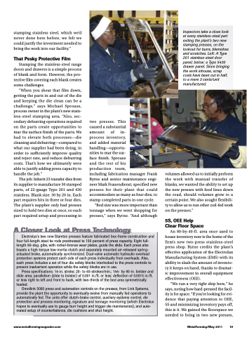

 stamping stainless steel, which we’d never done here before, we felt we could justify the investment needed to bring the work into our facility.”
That Pesky Protective Film
Stamping the stainless-steel range doors and drawers is a simple process of blank and form. However, the pro- tective film covering each blank creates some challenges.
“When you shear that film down, getting the parts in and out of the die and keeping the die clean can be a challenge,” says Michael Sprouse, process owner in the plant’s new stain- less-steel stamping area. “Also, sec- ondary deburring operations required on the parts create opportunities to mar the surface finish of the parts. We had to elevate both processes—die cleaning and deburring—compared to what our supplier had been doing, in order to sufficiently improve quality and reject rate, and reduce deburring costs. That’s how we ultimately were able to justify adding press capacity to handle the job.”
The job: Inherit 23 transfer dies from its supplier to manufacture 30 stamped parts, of 22-gauge Type 201 and 430 stainless. Blank size: 30 by 20 in. Each part requires hits in three or four dies. The plant’s supplier only had presses sized to hold two dies at once, so each part required setup and processing in
Inspectors take a close look at every stainless-steel part exiting the plant’s two new stamping presses, on the lookout for burrs, blemishes and scratches. Left: A Type 201 stainless-steel door panel; below: a Type 5430 drawer panel. Since bringing the work inhouse, scrap costs have been cut in half, to a mere 3 cents/unit manufactured.
