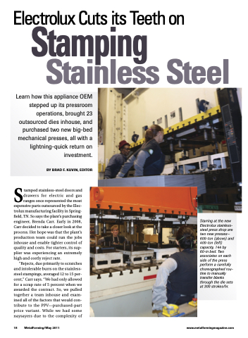

Starring at the new Electrolux stainless- steel press shop are two new presses— 600-ton (above) and 400-ton (left) capacity, 144 by 60-in bed. Two associates on each side of the press perform a carefully choreographed rou- tine to manually transfer blanks through the die sets at 300 strokes/hr.
