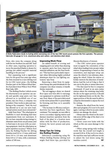

   A Kelly Fabricators tends to tooling while overseeing one of the two CNC turret punch presses the firm operates. The presses fabricate 22-gauge to 1⁄4-in. aluminum-alloy and carbon- and stainless-steel sheet.
