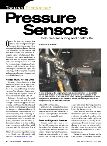

 Lube line
Sensor
To keep a stamping die properly lubricated, a pressure sensor can be used to monitor tank pressure and ensure that the proper amount of lubricant is dis- pensed. The lubricant in the tank or line exerts a force against the sensor’s meas- uring element, whose signals are converted into an electrical signal output for interpretation by the press-cell controller.
