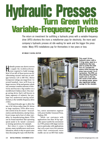

This small 10-ton hydraulic press, with a 7.5-hp motor, went to a metalformer that was able to justify the addi- tion of a variable-fre- quency drive because the press runs at only 1 to 2 cycles/min. The VFD, an Allen-Bradley PowerFlex model seen in the top- left corner of the electri- cal-cabinet photo, gener- ates significant energy savings for the stamper.
