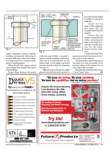

 Same as “D” diameter
D
Fig. 2
Flush to –0.001" below bottom of retainer
Relieve head (ref. Fig. 2)
press fit between 0.0003 to 0.0005 in. should be sufficient.
• Ensure that the head is fully supported and seated into the counterbored hole in the retainer.
• Ensure that the retainer is cleared for the radius connecting the head to the shank. Pro- vide just enough clear- ance for the radius. Avoid excessive clear- ance.
impact adequately without cracking, breaking, permanently deforming or severely deflecting. Softer and tougher tool steels such as S-7 are good candi- dates for backing plates.
When all else fails, using a punch with a larger body usually will reduce head breakage.
Proper fitup between the punch
body and punch holder is essential to prevent punch pumping, which basi- cally acts as a battering ram on the punch head. Good design and build practices should include the following (see Fig. 3):
• Make the body of the punch a slight press fit into the hole in the retainer. A
• Ensure the head of the punch does not protrude past the bot-
tom surface of the retainer.
• Fit the punch so that the bottom of
the head is as close as possible to the bottom surface of the retainer, but no more than 0.001 in. below.
Hopefully this will help relieve some of your “head” aches. MF
METALFORMING / OCTOBER 2010 67
10˚
Clearance
Head must seat properly. Provide clearance in the punch holder to clear the radius at where the punch head and body meet.
Provide radius here on the punch
Fig. 3
Press Fit
0.0003" – 0.0005"
