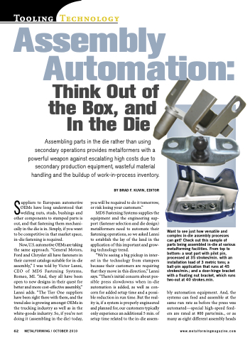

Want to see just how versatile and complex in-die assembly processes can get? Check out this sample of parts being assembled in-die at various metalforming facilities. From top to bottom: a seat part with pilot pin, processed at 35 strokes/min. with an installation load of 3 metric tons; a ball-pin application that runs at 45 strokes/min.; and a door-hinge bracket with a floating nut bracket, which runs two-out at 40 strokes.min.
