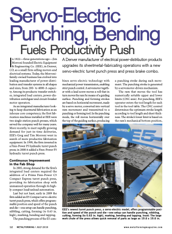

EEE’s newest turret punch press, a servo-electric model, offers programmable posi- tion and speed of the punch and die—one setup can handle punching, nibbling, cutting, forming (to 0.63 in. high), marking, bending and tapping. Inset: The large work chute of the press allows quick removal of parts as large as 19.6 x 19.6 in.
